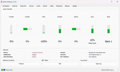

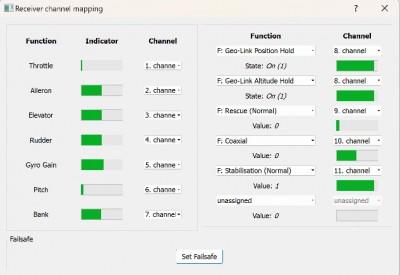

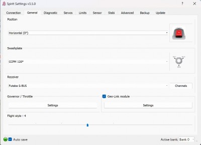

Please see attached pictures.

You've assigned 2 functions to the same channel. This may be the reason of malefunction. "Altitude hold" has two states of working depending on the programmed value: -100% and +100%. At -100% the pitch control is by the system without any exeption.
Is it right that you've combined GeoLink functions to the different flight modes permantly active? In my personal opinion, it would be better to separate this. In case of malefunction you can switch off and land normaly. Sometimes electronics don't make what you expect.
