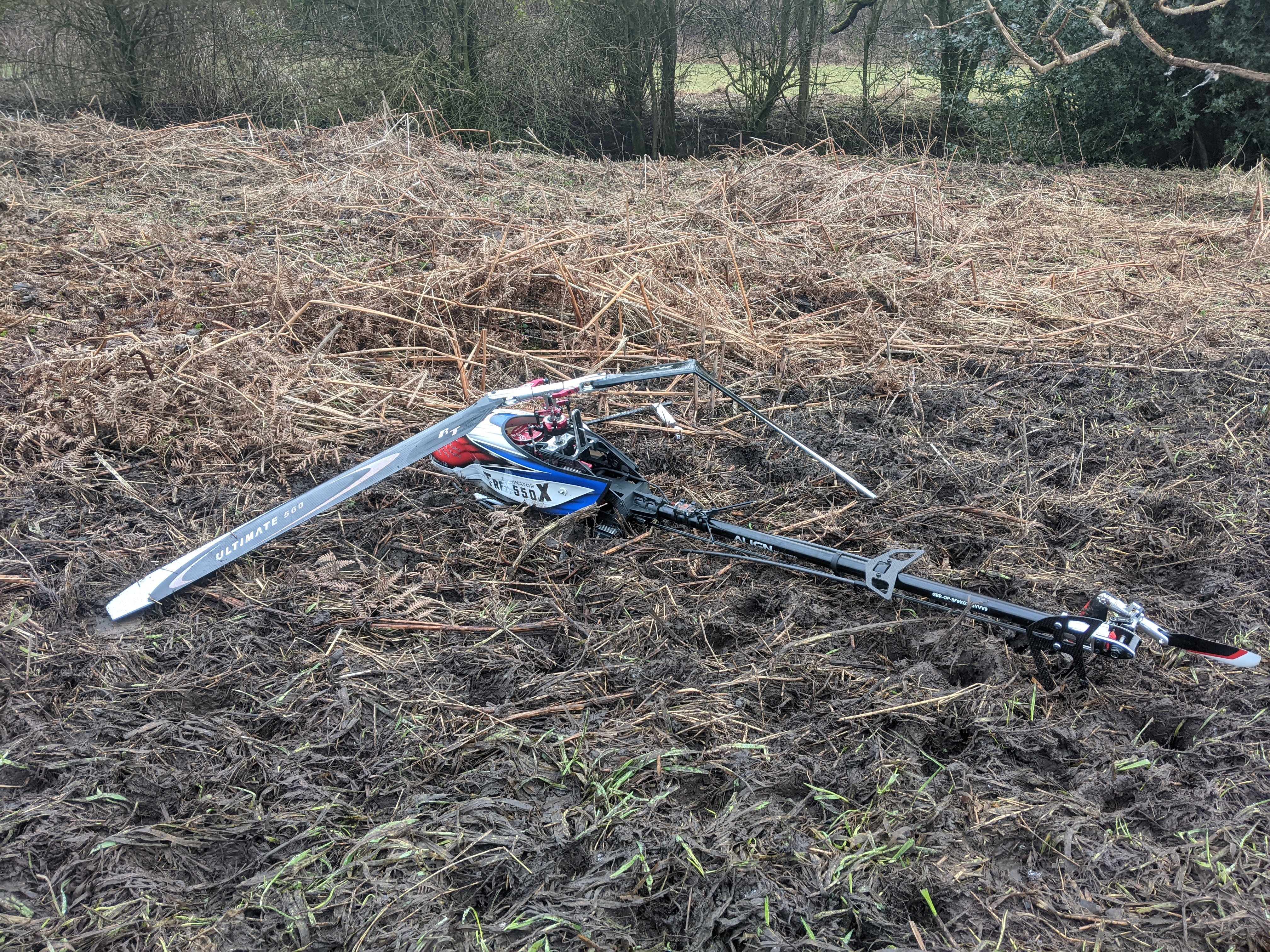

So, I got to test the new firmware in flight yesterday.
As per my bench testing, telemetry is working and I assume the 9747 sat was properly connected and ready to take control if needed. Sadly, I had a total loss of control when the model was ~30m altitude and ~120m distant. The model went to failsafe and fell to the ground. It's worth noting that I had auto-rescue enabled at the time, and as the model fell through the hard deck, it levelled itself before it hit the ground. No doubt saving a lot of damage.
I don't think this is an issue with Spirit, as about one hour before, my 450 heli (BeastX FBL) also lost signal and crashed. Either there is some interference with Spektrum radios there, or my DX9 is faulty.
Also worth noting that I couldn't download Spirit logs, since it said it was corrupted. I've had that a couple of times now...

Hi Mike, That's really sad, I'm sorry - Can you repair the damage ? I hope so !
It's a pity that no log file is available, which was actually the reason for the crash - it would also be nice if it were possible to log the separate values for fades, framelosses and holds via Spirit or if they could be transmitted to the Spektrum remote control, for example , then you could log it using a TLM file and evaluate it later - Since I could determine during my test that no reliable telemetry, mainly the resetting of the framelosses etc. could be recognized, the configuration with 2 satellites actually died for me - In that case I will probably use an AR6610T and a 9747 for larger helis in the hope that I can see the two antennas or at least be able to determine the lower values of the frame losses- For smaller models up to 450 you can use a 4651T, where the display of frame losses and holds etc. also works reliably - the evaluation for both variants can then be carried out after the flight (TLM file saved in the radio). When I get a chance, I will do another test with the AR6610T and 9747 configuration, testing it once with and once without ESC telemetry - The test without ESC telemetry will go quickly, the test with ESC telemetry will take a while until I have my XLPower 520 ready... that's where the ESC telemetry will be tested -

Thanks Matthias!
Thankfully the damage wasn't too bad - I have not yet checked everything but it appears to be only blades, canopy, skids and tailfin. Maybe the feathering shaft. The soft mud certainly helped - the frames were full of it. I was lucky also because only ~10m away from the crash site was a river!
I have sent my DX9 to a service centre to be checked, to rule out any issue with the TX.
I'm unable to do any more testing at the moment. As soon as I have my TX back I'll try to do some basic testing on the ground to see if telemetry logs are still broken with 3.3.4. I will flash back to 3.3.3 to test this if necessary.
Interested to see your results of more testing....

Ouch, that is painful to see.
Did you happen to look at your transmitter before you powered it off to see if any holds were reported?

Yeah, it was a bad end to an otherwise great session!
Two holds and over 1000 frame losses. Flight lasted about five minutes.
The first hold recovered after a split second (I could hear the rotors start to spool down for a fraction, then recover), but then it immediately had another hold which caused the crash.
I've tried to keep an open mind as to the cause, but there's no single theory that stands out. If the TX is given a clean bill of health I'm not sure what I'll do. May have to save up for a Jeti DS-12...

Joined: Wed 21. Dec 2016 15:13:38 Posts: 492 Location: Germany
Hello Mike, interesting information - 1000 Framelosses are very high and then only two holds ? Is the area known for radio interference ? For a flight of 5 mins it is much to high ! What have you seen before with only the 4651T, was this significant better ? I don't think that you can trust this information of framelosses , especially since the teltmetry is unstable with two satellites - I have read various information on the internet, as an example if there is no signal for one second at any antenna, this results in 45 framelosses with a corresponding hold and an hold means failsafe - Framelosses are also consequence of flight time. It is seen as a connection quality. The longer the flight time, the higher the number of frame losses can be, with the same connection quality - Have you an friend with an OpenTx Radio maybe TX16S ? In the TX16S you can make a spectrum analysis on your flight location, here you can see maybe more significant Interference in the 2.4 GHz range, maybe this helps too for the cause research -
Many greetings Matthias
