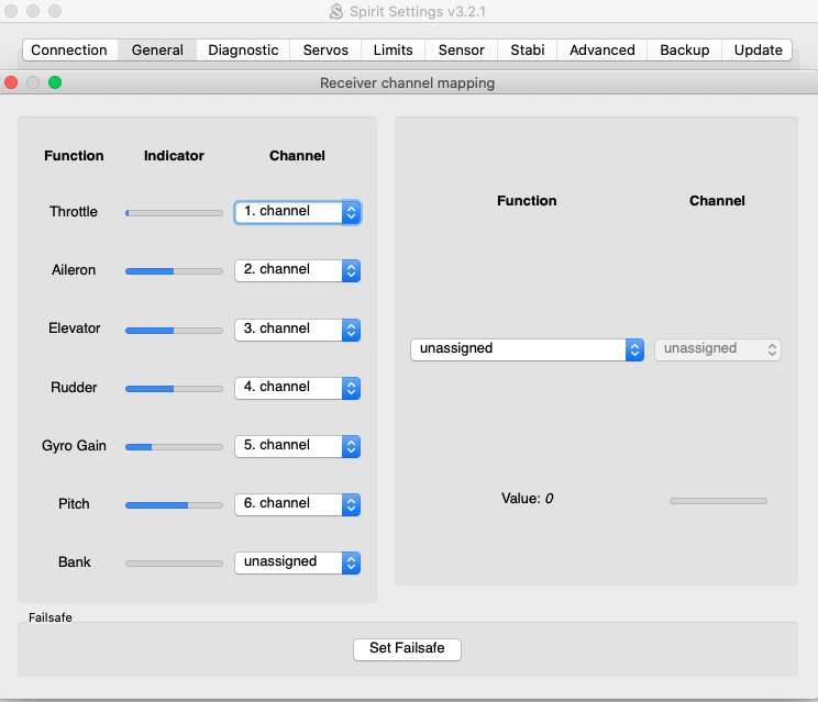

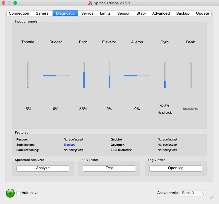

Hi.
This is probably a really dumb question but....
I've set up my Spirit on my Trex 450l following the manual and the wizard and it's doing everything I think it should.
I've got Stabi on my 5th channel, but i'm unsure about this bit.
My question is where do i adjust my Gyro now? Do i still do it in the TX under Gyro? My plan is get that set right and then set that in the Spirit so I can free up that channel for Rescue..
The numbers in diagnosis don't match the numbers in my TX and this is confusing me too.
EG in TX GYRO = 69% in Spirit = -50%
TX GYRO = 315 in Spirit = +50%.
Hope that makes sense.

HI
First you have to check that the gyrochannel 5 is not rev,increce the value in tx and look in general
tab that the numbers increces there to.Then you use a switch assign to a mix in tx and mix in a -number to the gyrochannel 5,so when you hit the resque switch the the gyro value
changes from + to -,that activates the resque in Spirit.
http://manual.spirit-system.com/index.p ... #STABI_TAB
//Latjo

Ok my GYRO was reversed. I have changed that now. When i increase GYRO in the TX the number increases in the Diagnostic tab. When I have the GYRO at 31% in the TX it is -50 in the Diagnostic tab and the Stabilisation says Engaged.

When it says Configured (Gyro Gain) does that mean i can adjust the Gyro from my TX?

Hi
You have to solve the issue whith channel 5 gyro in tx maybe you have some subtrim or the end points not right -100 100 subtrim 0,and no mixing.Look in tx monitor that channel 5 moves from 0-100%.
Resque activeted depends on that you have a neg value in diagnostic tab gyro channel 5.
https://www.youtube.com/watch?v=BQZoTeE1KP4
https://www.youtube.com/watch?v=fZj7u1r--is
https://www.youtube.com/watch?v=WVRHJSQ ... v_&index=9
Diffrent videos on setting up gyro on a heli whith DX6i.
//Latjo

Maybe it's my D/R?
I can see in the monitor window on my TX that ch5 doesn't go from 0 to 100% but i can't see why.
Travel adjust is all 100%
Sub trim all at 0%
It's definitely activating rescue/stabi or whatever i've got selected.
 Post subject: Re: Adjusting Gyro Dx6i
PostPosted: Thu 24. Dec 2020 15:58:29
Joined: Thu 06. Dec 2018 15:14:10
Posts: 9
Just realised it's not doing 100% because of my GYRO settings.
That makes sense i guess.
I'll watch the videos now.
Thank you for your help!
