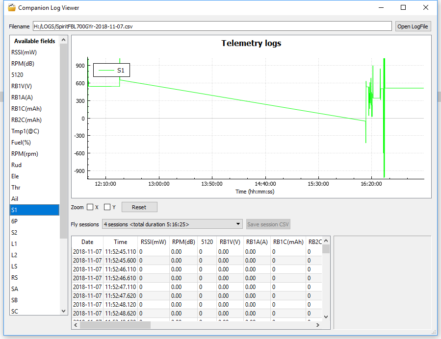

Matzer27
Posted: Tue 13. Nov 2018 15:57:57 |
Joined: Tue 01. May 2018 15:26:53 Posts: 10
Here the Telemetry logs of the gain and the Ruder.

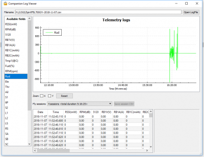

Matzer27
Posted: Tue 13. Nov 2018 16:02:58 |
And here the Ruder

Posted: Thu 15. Nov 2018 9:11:04 |
Site Admin |
Joined: Mon 29. Apr 2013 16:06:44 Posts: 12248
I recommend to set Rudder delay to 0. Then we dont know anything about rest of your settings. Could you attach your settings file (4ds) here, please?
Very likely the problem could be in Pirouette Consistency settings value.
When looking at the Diagnostic tab in the Spirit Settings, can you see that the Gain is really changing and reacting to your radio?
